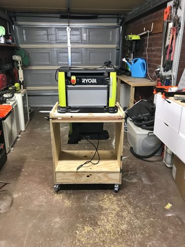

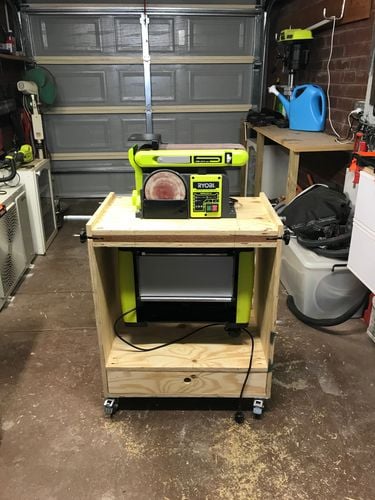

So I’ve been running out of space in my garage/workshop so I built a couple of mobile stands to house our Ryobi tools.
Fliptop tool stand holds the belt/disc sander and the thicknesser.

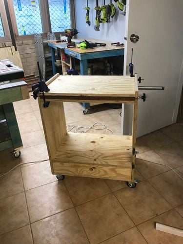

It pivots on a piece of 20mm galvanised pipe housed between two side supports and locks in using eyebolts and hex head bolts!

What's the weight of the Ryobi thicknesser?
I'm sure it's well secured. 😉
Re: fliptop tool stand
It weighs 30kgs and yes it secured with 4 HD bolts!

I've just about finished my flip-top cart (different design, though) and am about to mount my thicknesser and sander. What troubles me is that the Ryobi sander seems to have only two holes for mounting - I'm guessing that they didn't anticipate people hanging them upside down! How have you mounted yours?
