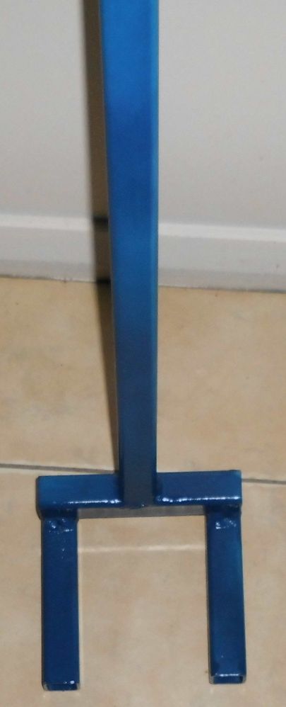

Can someone help whats would be the easiest way to dismantle a pallet I cant afford $90..00 for the tool that yes would work well, ideas are all over youtube but some still need expensive tools that may only be used a couple times
Bundaboy
Pallet breaker (short version) fork

Hmmm I am new to this forum, at least in how to post things, I have one picture that seems to be postable (below) but the other not-so-much for some reason - if someone could tell me what I am doing wrong it would be appreciated.
https://www.workshop.com.au/t5/Gallery/Pallet-breaker-short-version/cns-p/30961
Anyway, this is as easy as it gets, but in truth I added another section to the handle doubling it's length for extra leverage, but it was joined with a short section of the next size up tube that slipped over both sections with bolt holes so that it could be dismantled to fit in the boot - I would recommend doing that as some pallets need the extra leverage.
Edit: I should add that it doesn't get much simpler than this design, but it works well.

Thanks so much @Bundaboy...
You posted as a link instead of uploading an in-field image, somehow.
Yep, I can see the extra leverage would be helpful if you're trying to rush through a dismantle on site. Archimedes had it right, what he said about the lever.
I reckon I can manage to weld that. If I can't I should probably go belly up, lol.
Now to convince hubby to let me stop for more pallets...
