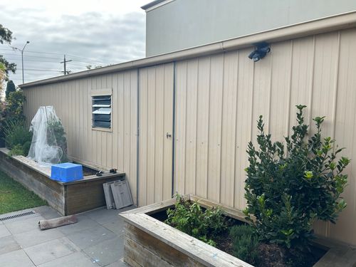

Hi there, I have an old stainless steel shed that’s an off colour. I am planning on turning half of the shed into an office space and I wish to update the exterior as well. I was thinking of cladding the existing flat SS with a new, corrugated colorbond sheet in the colour I want. Can this be done? Can you cover existing steel sheet with new steel sheeting like the corrugated sheets? Or are there problems with screwing new steel sheets onto old ones? My other option is to paint the whole shed in a new colour but this seems tedious and I don’t like the current steel sheet type. Thanks in advance

In order to give us a better idea of the condition of your shed, would it be possible for you to post few photos? We can then assess if your current walls are strong enough to hold the Colorbond sheets.
One of the key points when mounting anything on a shed wall is the framework. If the old shed has a steel frame around it and is still in good condition, it might be possible to anchor the new sheets onto it.
We should be able to give you better suggestions once we see your shed walls.

Thanks for replying to the post Jason, images attached. The shed has a part steel frame part timber

Hello @jamor
Thank you for sharing the photos of your shed. The shed panels still look like they are still in very good condition. The shed seems to be supported with a combination of steel and timber framing as you mentioned. Your proposal of putting another Colorbond sheet over your existing wall could possibly work. However, water might get trapped between the sheets and accelerate rust development. I suggest removing the existing sheets and replacing them with new ones.
Another option is to spray paint the Colorbond panels you currently have. It's an easier alternative to disassembling your walls and is a cost-effective solution. Plus, you get to choose the colour you want.

Thanks Eric, That's really helpful! I reckon i'll go ahead and paint it. Thanks,
