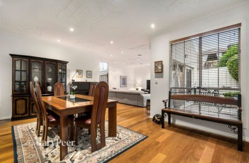

Hi all,
I'm looking to convert my garage into a second lounge room and would dearly appreciate some advice re flooring. The current floor in the garage is plain concrete, and I'd like to match as close as I can to the floorboards in the rest of the house (see picture). Is setting floorboards over concrete feasible or must I simply go the floating floor route? If the latter which type would best suit to match the my other floorboards and look and feel as real wood as possible? Many thanks in advance!
