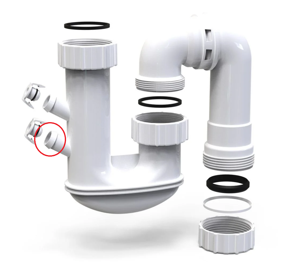

You would need to connect the hose directly to a spigot on a sink trap. It gets pushed onto the spigot and clamped in place. If you have a sink nearby, then there might be an available spigot on its trap. This PVC would then need to be capped.
As the installation of a trap or capping off a pipe is considered plumbing work, it needs to be completed by a licensed plumber. However, if there is a spigot nearby, you could connect the washing machine hose to it yourself.
