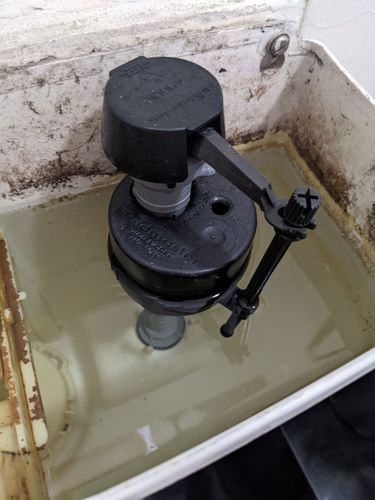

Thanks for the detailed trouble shoot...it's not a ball valve. It's one I installed from Bunnings a couple of years ago...but I'm unsure where to look for grit?

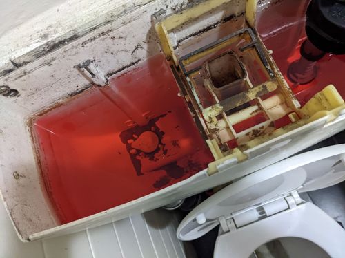

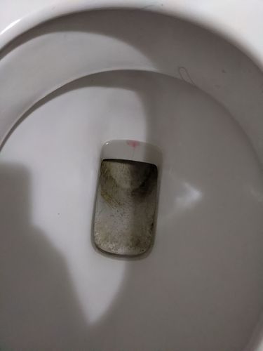

Hi thanks for the clarification. I'm not 100% sure where to look for grit or stones but to my eye there doesn't appear to be any. I attached pics of the valve in my reply to @MikeTNZ
Meanwhile, here's the results of the dye test. I'd say we have a problem

Hi @rosharch,
It could be the inlet valve seal or the flush valve washer. Turn the water off at the mini cistern cock next to the toilet. This turns off the water to the cistern and eliminates the inlet valve as a consideration. If the dye continues to flow into the pan, you need to replace the flush valve seating washer. You must remove the flush valve assembly to access the washer at the bottom.
If the dye stops leaking into the pan after turning the water off to the cistern, it's the inlet valve seal. That's a simple fix. Just pop the black cap off the inlet valve on the right and replace the rubber valve.
Given the flush valve's vintage, I suspect its washer is the culprit. Have a look to see if you can find some clips that, when released, allow you to pull the assembly out.
Let me know how you go, and I can guide you through the replacement process.

Turning off the water to the cistern resulted in almost all the red dye remaining in the cistern itself. There was some small amount of red dye in the bowl but seeing as before it was a continuous flow of dark red, I'm going with inlet valve seal.
Do you think it needs replacing seeing as I bought the entire valve and seal from Bunnings only a year ago? Is it perhaps just an adjustment that needs to be made?
