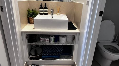

So I have this power room downstairs that I’d like to update however everything in my house is always odd sizing or too hard.
Wall to wall is 880mm - the built in cabinet is 800mm.
(the doors are off because I’m going to paint them however I’d prefer new doors - I like the shaker style, but my current doors are shorter than the kaboodle ones)
The new cabinet sizes seem to be 750 or 900
I feel like I’d like something new as everything is built horribly.
id like a new basin, as this one is quite large at 520x420.
any suggestions would be appreciated! 🙏🏻

You'd possibly need to look at having something custom-built to fit in the 880mm space snuggly. Alternatively, you could offset a 750mm vanity to one side and use the additional 130mm for toilet roll or towel storage. To replace the cabinet, you'll likely need to remove the benchtop and the tiles set on top of it. It will be a bit of work to replace the cabinet, but well worth it if you're after something new. How horribly built is the vanity cabinet? You might be able to use longer Kaboodle doors still, as there is no bottom edge of your cabinet carcass that would restrict the length of the door. So, you'd be able to have a door from the bench down to near the floor.
Have a look at this helpful guide on How to build a custom bathroom vanity. In such a small space, I like the idea of switching to a round basin sink and shifting it into the corner. That would provide a decent bench space. You might also like to check out our Top 10 most popular bathroom renovation projects for inspiration.
Let me mention some of our members that have contributed amazing bathroom renovations @homeinmelbourne, @daniknight4 and @annettespanski to see if they have some input.

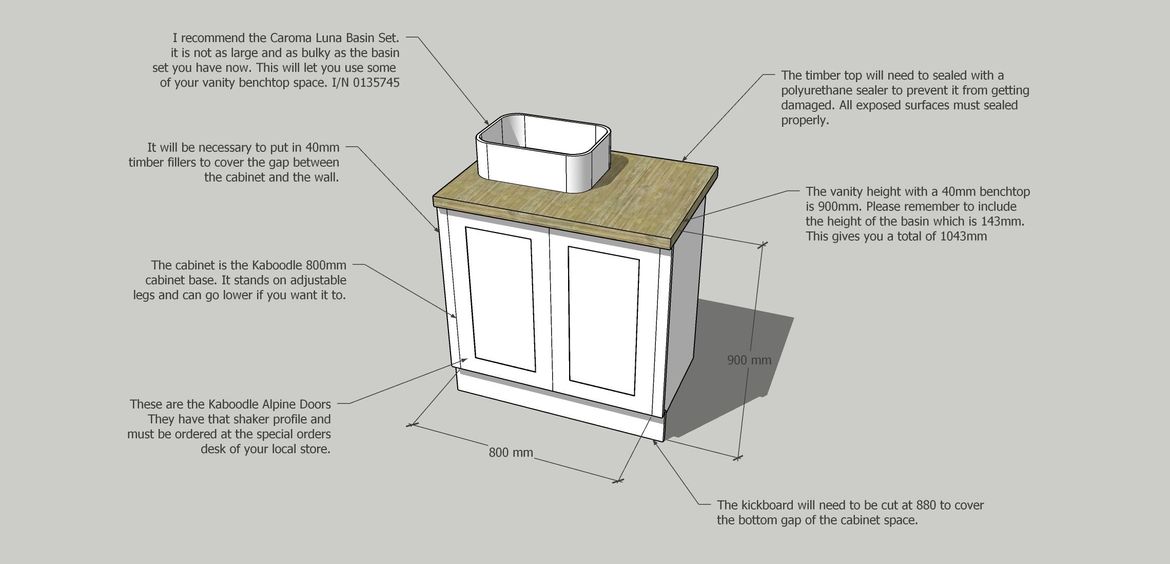

It's great to see that you've received excellent advice from @MitchellMc. Just to add to the suggestions made, I recommend having a look at the Kaboodle cabinet base. I understand that it is not 880mm, but it is taller and that means that you'll not have to bend over too much when using the vanity basin. Plus you can order the Alpine doors which have the shaker profile that you are after.
I've placed a sketch below with notes on what you need to look out for should you decide to use the Kaboodle cabinet. Please have a look and tell me what you think.
