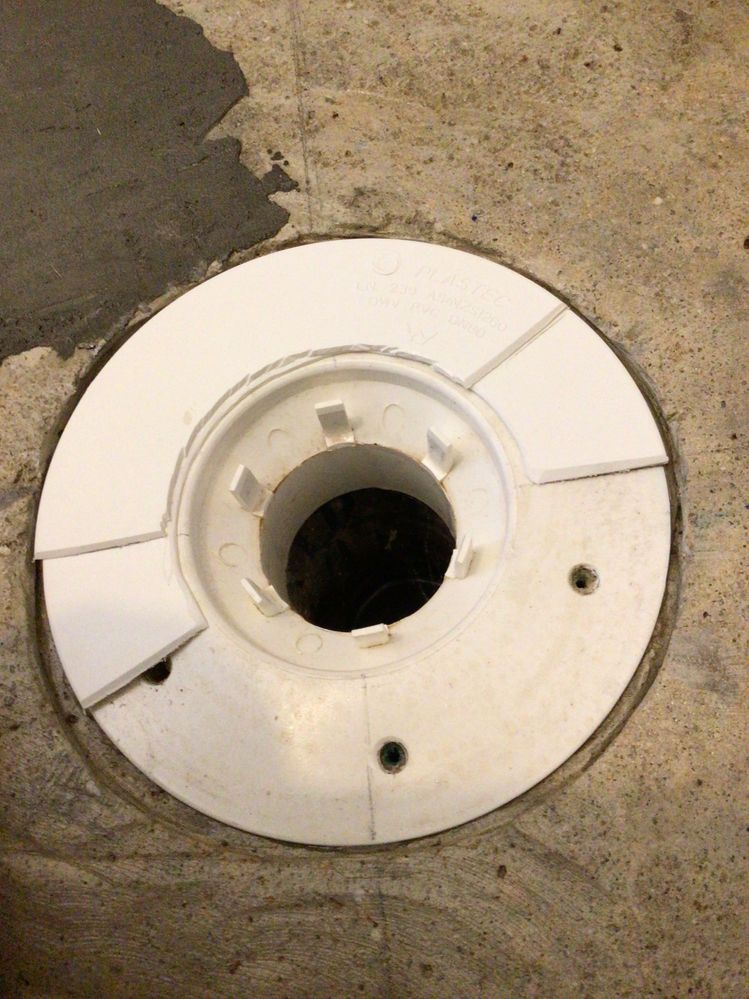

I have recently installed a puddle flange into a concrete shower floor and because the original house plumbing was not quite vertical and because of different slopes of the existing floor my puddle flange is about level with the concrete on one side but is about 5mm below the concrete on the other. Because of the slopes on the floor I have decided to use sheets 300x300 of 90x90 smaller tiles(if this makes sense).  I do not wish to grind down the higher concrete as this would make the slope too great on one side.  Any ideas for filling this area before the waterproofing is done please.

Thank you Jacob’s for your help.  Unfortunately the puddle flange is glued into slightly out of plumb pipe work and siliconed to concrete.  I often over engineer things!  The puddle flange is a little out of level unfortunately but I have butchered another puddle flange to try to build up the low area by glueing part of the butchered flange on top.  If I did this would it affect the legality of of the puddle flange?  It does make it close to levelIMG_0101.jpeg

Unless I am missing something, you maybe over thinking this. Remember there is waterproofing and a layer of tile adhesive to go on top which could be applied to compensate.

Thanks Nailbag, you are quite correct, I do have the tendency to over think and over engineer things.  I just like to get things right.  I have been known to completely rip things up and start again but in this case I am damn sure I do not wish to do that.  Thank you for your helpful reply, I will go along with that.  My only issue, that I will just have to suck up is getting the smaller tiles level around the floor drain. Thanks again for your constructive suggestions.
