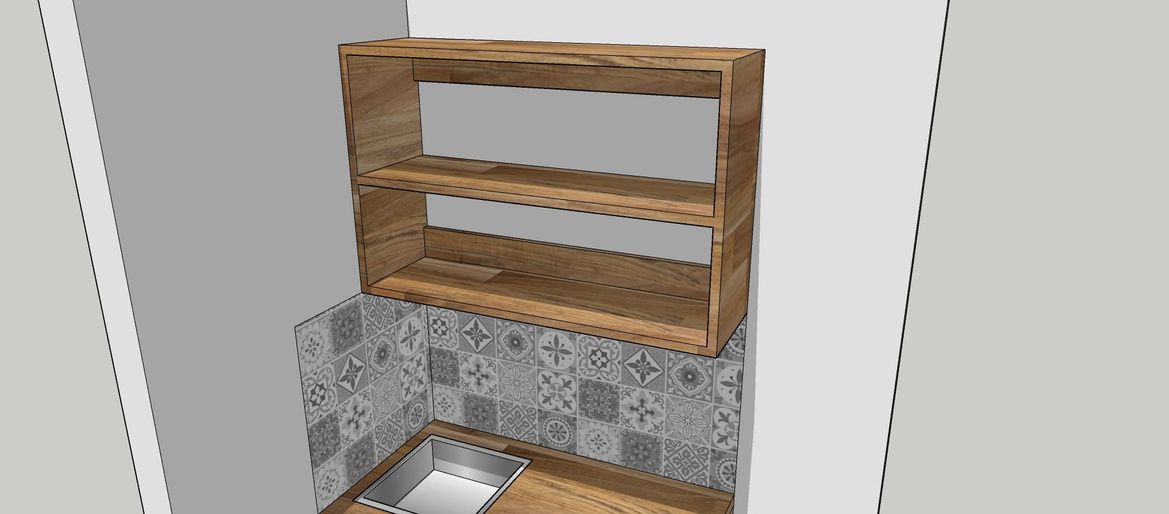

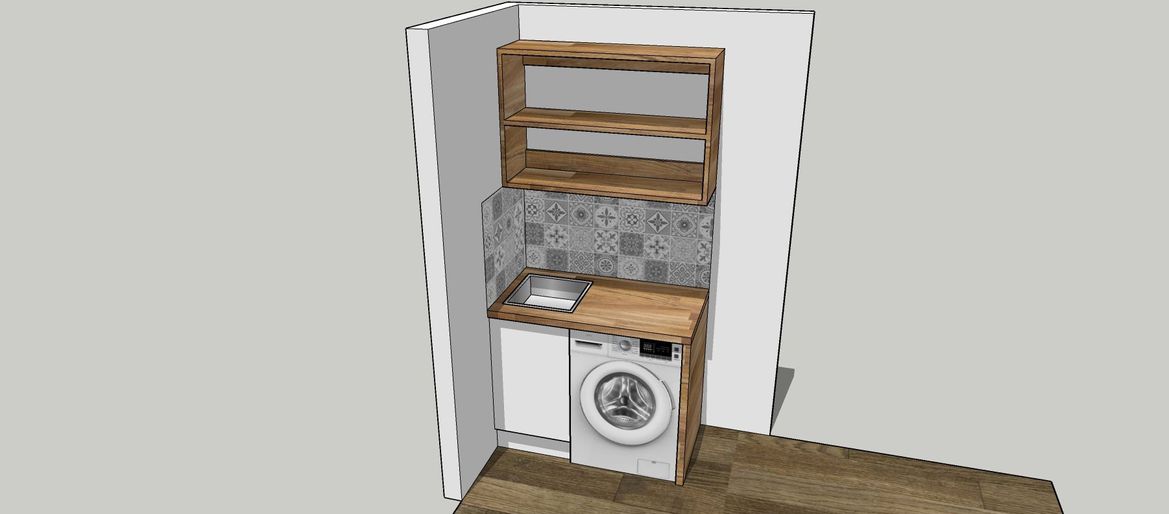

Hi @Louise88
Here is another version of Mitchell's proposal but with a timber benchtop and shelf. The benchtop is the Specrite 2200 x 600 x 26mm Timber Multi Use Pine Panel. If you are using the Kaboodle 450mm White Base Cabinet the length of the panel should be more than enough to create a waterfall feature. If you purchase another panel, you should be able to create an open cabinet to mount on the wall. The sink is the Estilo Stainless Steel Single Bowl Square Sink.

Re: Laundry Renovation on a budget
Hello @Louise88
I think both of them look pretty good, I've placed an image below to help you decide.

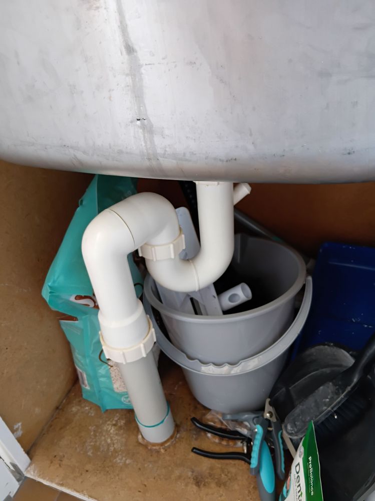

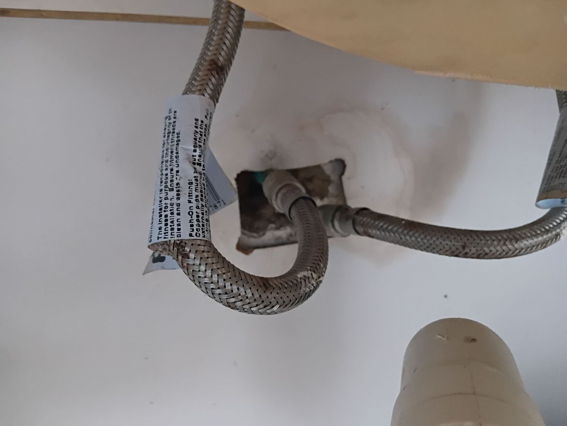

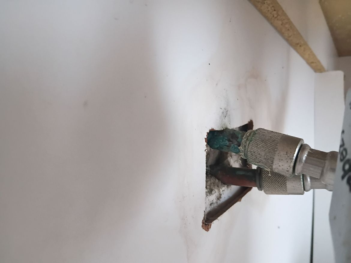

I have just started this renovation and will take the existing vanity and laundry sink out soon. I plan on doing this myself and getting a plumber to install the new sinks and taps. I have replaced my shower taps and head myself recently so feeling confident about removing the laundry sink tap and capping that off, but am a bit worried about the vanity sink.
Has anyone removed tap connectors like this before - any idea if I will be able to remove and cap myself? Looks like it could be simple but  worried about not being able to use a spanner if they're tight/stuck on.

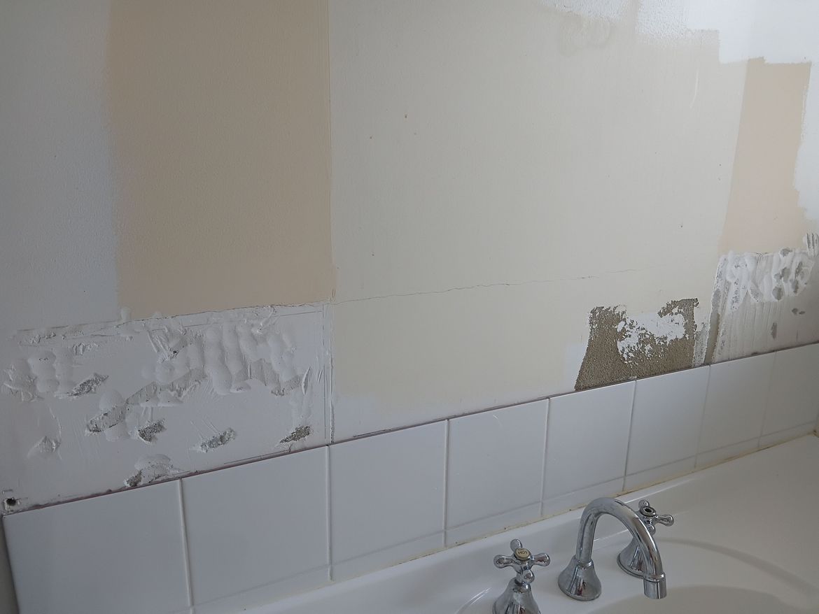

I also took the mirror off the wall today and underneath it looks like this. Any ideas on how I can level this so I can paint it?
Also wondering what I should do with the pipes that go into the floor when I remove the vanity and laundry cupboard - do I just cap them off as well?20250202_175835.jpg20250202_175848.jpgThis is the wall which was behind a large mirrorThis is the wall which was behind a large mirror20250202_113901.jpg20250202_175809.jpg

Hello @Louise88
I highly suspect that the fittings you have under your sink are non-standard and could cause you issues when you take them apart. It might not use standard brass cover caps; I've not seen these types of fittings before. I suggest engaging the services of a licensed plumber just to be safe. In regards to the pipework, I recommend leaving them alone and just covering the exit with a plastic bag and a rubber band to prevent sewer gasses from entering the room.

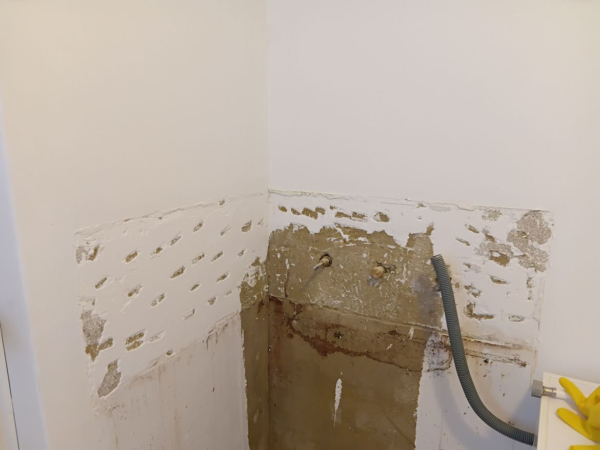

I have now managed to disconnect and cap all the other plumbing and have taken out the vanity and cabinets. I have also removed almost all the tiles but I am a bit stuck where to go from here!
I believe my walls are cement render with a thin layer of plaster on top. Can you please advise how to prep the walls now ready for painting and retiling?
Do I need to fill in any holes in the concrete or can I just put in a layer of plaster?  Some of the tiles seem to have been stuck straight onto the concrete and others onto the plaster...
I have also discovered this weird hole under the tiles under the window. Do I need to fill this in or can I just remove the tile adhesive and stick new tiles on top?
Thanks so much!
