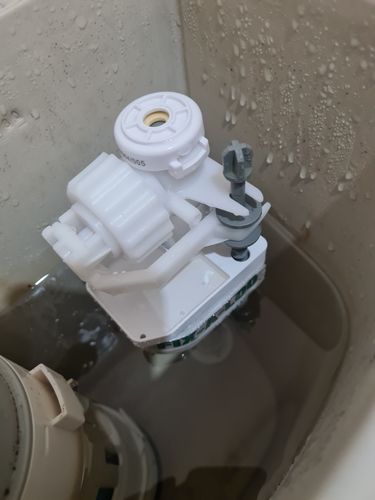

I just installed the kinetic single flush outlet valve, after cutting the tube and grey rod like thing to make it fit in the cistern, I followed the instructions to put the full flush level (grey lever) at the lowest number for maximum amount of water, and same with the half flush lever, but hardly any water goes into the toilet bowl. I have to hold the button down to get the toilet bowl to fill with enough water to get rid of the crap..the cistern is full of water so this is not why it’s not flushing properly.
can someone help me with how to adjust in order to get more water when flushing the toilet

Thanks @KatieC, @Angie00 your outlet adjustments control the amount of water that will let go at once.
Your inlet will control the rate of water that comes in to fill up and the height that it fills to.
Your cock valve down on the wall will also determine the amount of water flow (speed) it comes into the cistern.
I would check your levels on the inlet and also check your cock valve.  See how you go from there to start with

How long do you need to hold the button for the full flush? If it is more than a couple of seconds, it sounds like the valve is not releasing enough water for your pan. How old is the pan? Older pans can require more water to flush than newer-style pans designed to be water-saving.
If all the adjustments have been made correctly, it sounds like this valve might not be compatible with your toilet. I'd suggest having a word with your local store's Special Order desk to see if there are other options instead of this universal flush outlet. If the product isn't fit for purpose, our team in-store will return it for you.

I was holding the button down for 4-5 seconds for full flush.
i ended up taking the flush valve out to have another close look at it, if I hacksawed more off then I’d have to reduce the amount of water going into the cistern as the flush valve would fill with water, I didn’t want to do this as this is an old toilet and needs a lot of water to flush properly. I resorted to adjusting the height of the flush button mechanism but now there is a small gap between the lid and button, you can slide a thin piece of cardboard in the gap, but it isn’t very noticeable. I figured this is a small price to pay for a working toilet.

That sounds like a good compromise, @Angie00. Well done on finding a solution to the issue.
