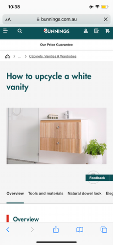

I’m contemplating upcycling a white gloss bathroom vanity with some half round timber dowel - similar to another project I saw on these discussion boards.
I’m wondering if I need to seal the timber dowel with anything, given that it’s in a wet area?

It's great to see you've had some inspiration from How To Upcycle A White Vanity and it's exciting to help you with your project.
You will need to seal the timber to prevent any moisture damage and rotting in the future. I suggest coating the timber with a clear polyurethane varnish such as Cabot's Clear Polyurethane Timber Varnish. This will give the timber good protection while maintaining the natural appearance that looks so fantastic.
