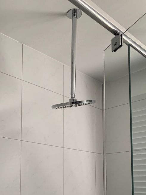

Currently I have a rain head shower, which is installed in the bathroom as seen in the image.
Due to certain reasons, I would like to attach a handheld shower to the current fitting.
Can you suggest the best approach to doing this as a DIY project and the materials needed please.

It is possible to attach a shower rail handset to the existing outlet of the shower. I propose removing the rain head shower arm and replacing it with a Brasshards 15mm Male / Female Chrome Plated Brass Elbow. Before attaching the elbow to the brass outlet, make sure to use Kinetic 12mm x 10m White Standard Thread Seal on all threaded sections. I then suggest attaching a Mondella Resonance Chrome Horizontal Shower Arm to the chrome elbow.
By attaching those two pieces I mentioned, you'll be able to attach the standard hose of an Estilo WELS 3 Star 9L/min Serena 3 Function Shower Rail Handset. However, it will be necessary to drill into the tiles to mount the shower rail.
