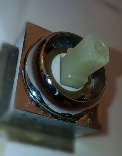

Thanks for chipping in. I'm not sure a pic from the side with make much difference to what I/we know. Although please see attached.
Essentially, I'm just trying to replace the leaking cartridge. My issue was not being able to remove the chrome cover ring (flange) thus far.
Having removed the square backing plate on the wall there doesn't even seem to be enough room to undo the square "copper sleeve". The tiles have been cut snug & square & won't give clearance to rotate through corners.
Hence, I wanted to be sure about disassembly so I don't damage just for a cartridge replacement.
Unfortunately there are no signs of thread from the outside. All that's visible is the chrome cover.
Not knowing about a broad range of mixers I was concerned whether the cover flange is integrated with the retaining nut in this case (2 in 1).

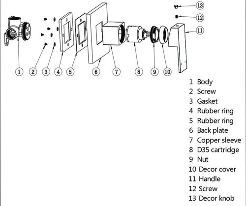

Looking at the Rococo spec sheet the backing plate size isn't shown. 117mm was a spec on the sheet for the depth from the handle to outside of brass T piece ("body" in exploded view of a very similar product).
I humbly take your point. I wasn't so aware of all the shower mixers that are almost identical to the Rococo. I see online there are other generic & name brands with the same size backing plate, the same size handle & body. Huh & duh!
Well, I assume the square cutouts are there to make it easier to apply leverage for the chrome cover flange. Then the brass nut with flat sides should be underneath. I have read that other DIY people have had a job of a time getting the chrome dress (cover) ring off.

Hi @bak4more,
Thanks for the images. We needed them to see if there was a cover over the nut. I might have missed it, but I didn't click that you'd mentioned there was a domed cover. I presumed the issue was that you couldn't remove the retaining nut. On the Rococo, admittedly straight out of the box, I was able to unscrew that dome cover easily. I suspect yours is gummed up and hard to unscrew; that's if it is the same design as the Rococo.
Try applying some cloth tape around the retaining nut to protect it and gently clamping vise-grips onto it, and turning anti-clockwise. Be careful not to scratch the cover.

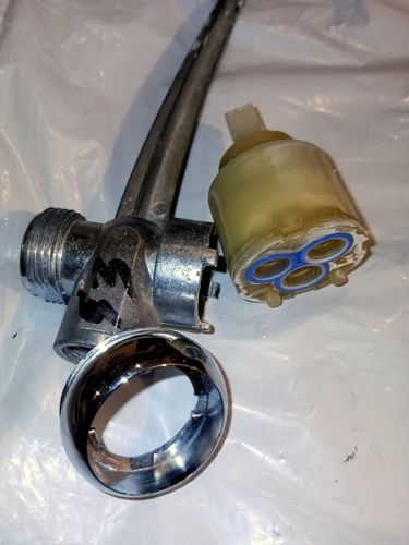

Thanks @MitchellMc for your help & prompting.
I roughed out a special tool & it was a 2 in 1. The retaining nut & cover wasn't on all that tight because it doesn't need to be. That's considering cartridge isn't metal & all that's really needed is the o'ring compression & seating.
Hopefully this helps anyone else with this design. It's hard to know if enough grip would be gained without marking surface. That's when trying to undo via chrome cover part on the outside. Plus, with special tool you get a good feel for just enough torque without overtightening.
