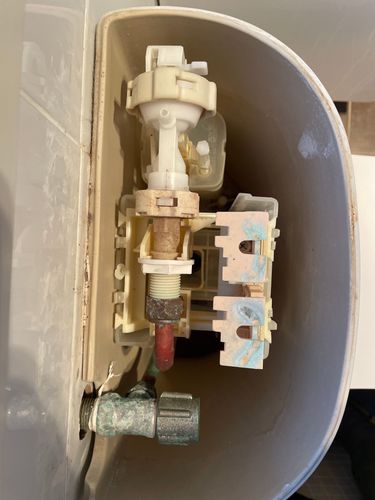

I have an old Caroma 2000 and need to change the cistern valve or washer however I can’t work out how to remove the old one. It has a water inlet tap inside which blocks the way. Can you help me please?

It's possible to remove the flushing mechanism and the inlet valve all in one go, however, in this instance I recommend engaging the services of a registered plumber. This is what is called an internal side mounted inlet valve, it is something I would not recommend as a D.I.Y project for beginners.
The disassembly process is complex and incorrect re-installation will result in a leak. An experienced plumber will know exactly what to look out for, how to release the tabs without damaging the housing and how to disassemble and re-assemble the filling valve properly.
Because of the age of the flushing mechanism, extra care must be taken when repairing this unit. Any incorrect application of force will damage the housing or main flushing system itself.
