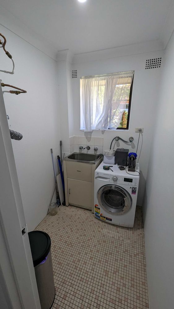

The question I have now is, when we are installing the cabinets and their support brackets into the wall, how do we ensure we do not hit any pipes?
This room is riddled with piping, and as you can see there are the taps for the sink as well as the laundry. The isolation valve is also in the corner of the room below the existing laundry tub and that "column" actually hoses piping as well.
I'm not too keen on causing a major water issue but we need to drill in several support bracket holes so not sure how best to do this.

Hi @dchur,
There's no real way to determine where the cables and pipework will be. Typically, cables run vertically or horizontally from powerpoints, so it is best not to drill in that vicinity. If it's a double brick wall, then most of this routing is down within the cavity, and you should be fine drilling into the wall. However, if there is a significant amount of pipework in that wall, I suggest employing the services of a professional to mount that cabinetry. At least then, they'll be responsible for repairing any damage to pipes or cables.
Thanks @MitchellMc , upon removing the existing laundry there are wall plugs there that give us an indication of a 'safe area' to add new ones too. We'll go slow and cross our fingers.

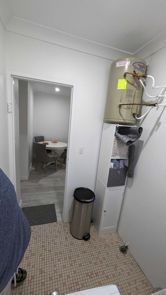

I have another query about the flooring. As you can see from the pictures the current flooring is very small tiles, which are original to the unit.
We had originally planned to use some 300mm x 300mm peel and stick tiles on the floor however the adhesive on these is not good, especially with smaller tiles.
I had a thought to use an additional adhesive such as sellys "hold up" which I've used with other projects. I did a test tile in an area that would be covered by cabinets and it worked perfectly, the tile is completely stuck down and definitely won't be budging.
My only concern about this is things like "tenting" and expansion of the stick on (vinyl) tiles. Given that the room is only 1.5m x 1.8m, is there any real risk of these issues? I have read some posts in other forums from people who have laid vinyl over ceramic tiles and then those tiles start to tent because they can't breathe properly.

Hello @dchur
I understand your worry concerning the peel and stick tiles. A lot of improvement has occurred in adhesive and materials regarding peel and stick tiles. Vinyl stability and adhesive longevity are now much better and have significantly reduced the phenomenon you are referring to.
However, I can't give you a 100 percent guarantee that the tiles will not lift. Factors such as age, temperature, moisture exposure and everyday use affect the tiles performance.
Because the laundry area is not so large, I propose having a look at installing Hanwood Hybrid Waterproof Flooring. You'll probably use a maximum of two packets to cover the flooring and it will look very similar to your flooring outside. The advantage of having clip-on flooring is that it is relatively easy to replace and repair.
In regards to the Selleys glue, I can't tell how it will react with the tile's current adhesive. But since you've already tested it, only time will tell how long it will stay down.

We decided to just give the Shelly's a go on the tiles. The test has been fine for a number of days now but I guess time will tell.
This stuff is super strong so I'll be surprised if there's any lifting.
Worst case scenario if it completely fails we will just get the laundry retiled properly.
Not sure how those boards you linked would work because the floor isn't that even so there'd be undulations.
