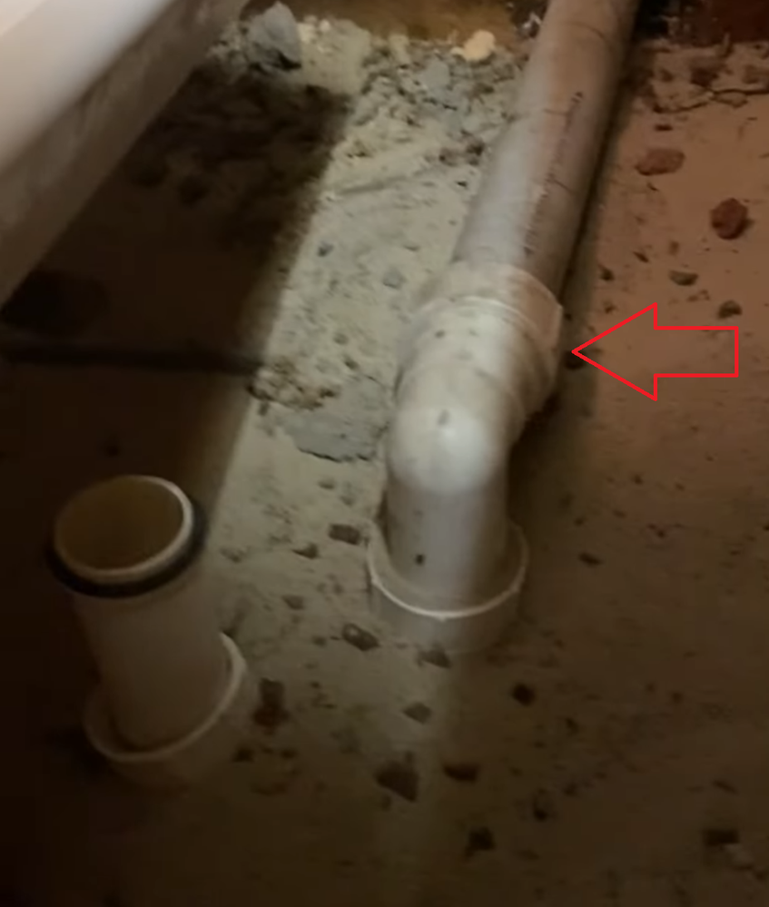

Re: How to block the drain - Now that bathtub is removed
Hi @Minitots101,
You can unscrew the S bend from the outlet pipe at the location I've marked below. It's the same process as undoing the pipe from the drain waste. Once you've undone this fitting, a 50 or 65mm cap can be glued onto the pipe to seal it. Just measure the pipe and pick up the correct cap at your local store. Please note that depending on your location, this might be considered plumbing work, requiring a licensed plumber.

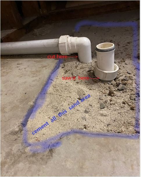

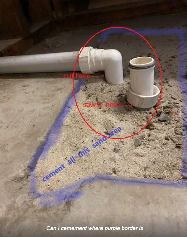

So, once the cap is glued onto the pipe to seal it, can I then cover the entire area in cement?

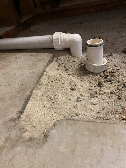

See a clearer image of the same pipes sitting in the sandy area, the rest of the floor is cemented.
Please advise 😁Can I cemement where purple border isCan I cemement where purple border iscan i saw the pipe lower and seal it?can i saw the pipe lower and seal it?
That is correct, @Minitots101. However, once you undo that nut and disconnect the pipe from the S bend, you should be able to pull this entire S bend section out of the sand; no need to cut the pipes.
