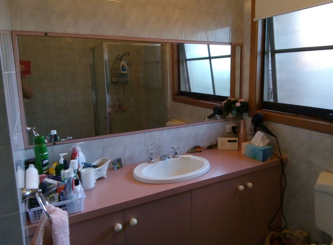

Hi All, Need help please, what is the best way to paint a Metal/Aluminium Mirror Frame currently Pink which was the trend 20 years ago have had a new shower screen installed (chrome frame) and would like frame on the big mirror to be a silver grey colour, full length wall tiles Soft Grey and floor tiles are Darker Grey (2 tones) and I love them, Have been told to spray can the frame so brush marks don't show I'm an elderly lady now so not sure which is the best way to go and I can't take mirror off the wall . Thank you
Ensuite bathroom mirror

With a little bit of masking preparation, you can change the colour of your mirror frame in a day. I suggest using ScotchBlue 24mm x 55m Original Multi-Surface Painter’s Masking Tape in combination with UNi-PRO 288mm x 50m Masking Paper - Twin Pack. Use the masking tape along with the masking paper to cover the exposed sides of the mirror frame. Then mask the inside of the mirror frame leaving the aluminium frame the only thing exposed.
Please make sure to remove all the items on top of your vanity and mask the vanity top to prevent overspray damage. With one last inspection check your masking handy work. Any areas you suspect will get hit with paint overspray cover it with masking paper and tape.
Here is a handy step-by-step guide: How to paint window frames
Now don't be confused, the steps for painting aluminium window frames is the same when painting aluminium mirror frames.
