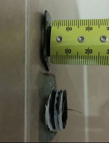

I have tried to install a new shower head but the protruding shower thread does not meet the minimum requirement to attach the new shower head.
is there a way that this can be fixed? Can the protruding thread be extended?

Is it that the protruding thread does not meet the requirement or that there is not enough thread for the showerhead to screw on? As long as you can get a few revolutions of the showerhead on there, that should be enough to secure it. If the showerhead does not screw onto the threaded section at all, then you'd need to extend it.
You could try attaching one of these 15mm threaded extensions, but you might find that your showerhead will not fit flush against the wall, creating another issue. Unfortunately, this is likely a case of needing a plumber to solder on a new threaded section of the appropriate length for the shower head or looking for a new one that suits your current setup.
The amount of exposed thread is typically all that is required to mount a showerhead. Does your new showerhead have a backing plate of a thickness that makes it impossible to attach to the limited exposed thread? Can you install the showerhead without the backing plate?

Thanks for sharing your knowledge Mitchell. We are encountering the same issue, and have tried an extension but as you mentioned might create a different issue, the shower head won't fit flush with the wall.
We need a backing plate to cover the hole in the tile, and have sort alternative plates without much luck.
I think the solution for us will be getting a plumber to solder an extension onto the pipe.

Unfortunately, you're likely correct that having a plumber change the fitting on the wall is the only option. You could try different styles of shower head, but extending what's on the wall with fittings can be difficult.
