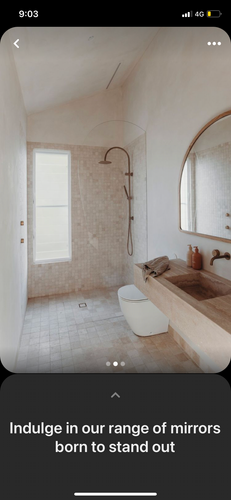

Hello! We are about to start renovating our bathroom (on a budget). We love the look of Microcement but are curious if it is possible to apply DIY and a rough cost. The bathroom itself is small and a wet room bathroom hence why we would like to try this rather then tile the whole room.
Looking at this online there aren’t many kits or diy options but noticed Dulux does make some. Has anyone used this? Any advice would be lovely.
photo for reference of desired vibe.

Congrats on your first post! And I am loving your vibe photo, I can see why you want to achieve this look. Our resident D.I.Y. expert @EricL will be online this afternoon but let me also tag in members who have used the Dulux Effects range @abhayks@lauraahearn, and @jennih to see what advice they have to share. In the meantime, I suggest you check out the video for Dulux design concrete effect paint to get an idea of how to apply it and the materials you need to gather some costs.

Thanks for sharing your question about Microcement. Dulux does have a product called Dulux Creativo Microcement and currently retails at $382.15 for 24kg. This is for their basic kit as there are quite a few options available. However, this product is not recommended for D.I.Y and requires training and experience to apply.
I'm afraid I can only suggest using larger tiles like the Bellazza 60 x 60cm 1.08m² Crema Porcelain Floor And Wall Tile. You can reduce the grout profile to 1.5mm which will give you a much more unified look. I then recommend combining it with the Dulux Special Effects paint in the non-wet areas to give you that rendered look.
