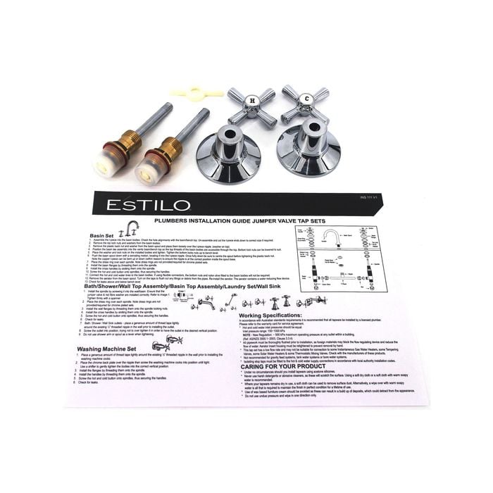

Hi Eric - I could upload a photo if you like but as I said in another post its just the one that comes with the estilo wall top assembly I got from you guys - https://media.bunnings.com.au/api/public/content/05b6221a4eb74d208b363f8cf0f438f3?v=f437540f&t=w700d...

I've placed an image below which should help with your decision making when it comes to spindles. Generally speaking, the standard spindle is technically the same height as a ceramic spindle. The only reason it will not fit properly is that the seat has been damaged, or it has been reseated too deeply. This is the part where you'll need to use the Doust Plumbing Tap Total Repair Kit to repair the seat of the spindle base. Please note that the locking sleeve of the ceramic spindle must be removed before installation.
The spindle with the extended bottom is called the deep seat spindle. It's the tallest of the bunch in the display, it will not fit a standard spindle body, it needs to be installed in a spindle base that is designed for deep seat spindles. If you are thinking of using a deep seat spindle in a standard kitchen brass body, it will not fit properly and it will not seat properly either. The last two images are of a ceramic spindle, one has the locking sleeve attached; the other one is the spindle itself without the locking spindle.
When installing the ceramic spindle, the locking sleeve must be removed first and the ceramic spindle body screwed in until it meets up with the spindle seat at the bottom of the body. There must be some screwing threads left on the surface so that the locking sleeve can be attached again.
