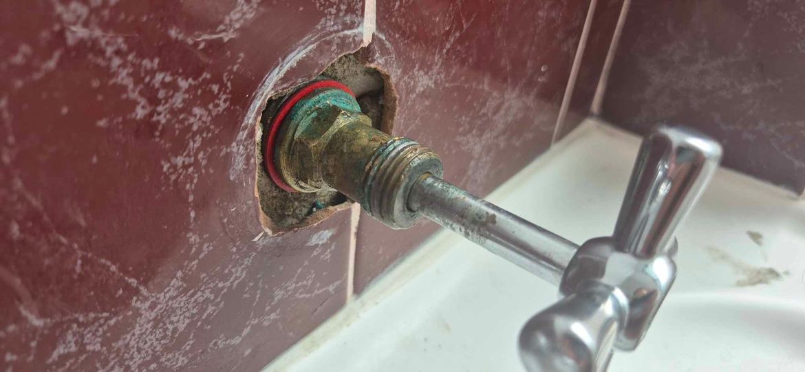

Good morning @Lynn3
Is there a chance of a photo so you can show where the leak is happening?
The picture I have in my head is that the water is leaking from next to the tiles and not out of the tap?
The spindal washer may have perished but will wait for confirmation/pic of where teh water is coming form.

Hi Dave,
Please see the photos here. The water droplets are more visible in the second photo.
Lynn
Re: How to fix leaking bathtub tap?
Hello @Lynn3
It appears that the leak is coming from the base of the spindle rather than top section. I can see that you have replaced the red felt washer of the spindle body. I propose using your shifter and tighten the spindle a little bit further and see if the leak stops. However, if the spindle is already very tight and it is still leaking despite the repairs you've made, it might be time to replace the spindle itself. It might be worn down or the brass threads have deteriorated.

I tightened it with a tube spanner, and it's still dripping. So I guess I have to replace the spindles. I'll definitely try the 1/4 turn taps, as they're easier to use. Thank you all!

Hello @Lynn3
Thanks for that update, if the leak refuses to stop, it's time to replace the spindle. My best advice is to bring the old spindle with you to the store to make sure that you get correct length when upgrading to the ceramic set.
