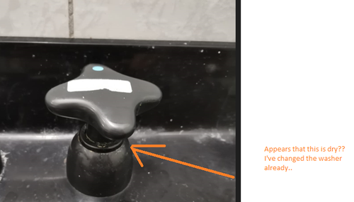

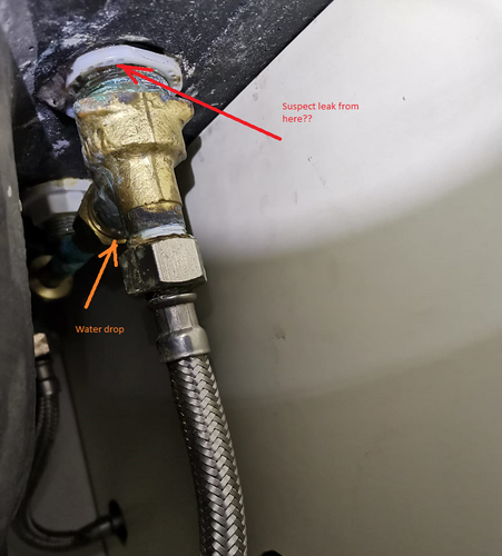

Hi, there was this kind of leak that I cannot know what is the problem...The issue is I've changed the washer tap, leak wasn't from the tap handle though. Is there a possibility that a washer underneath that need replacement and if that's the case, is this a DIY job or professional help? If DIY, how do I dismantle the part below? any video that can help?

Comparing to what I have under my vanity - your photo above appears to have a lotta exposed thread showing at that connection where the 'drop' is?

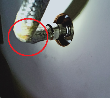

Your second picture with an orange circle is indicating a leak. There is the possibility that the compression olive has cracked and needs to be replaced. If the leak continues despite the repair odds are the body of the brass tap has cracked and is letting water out. The only other repair option is to replace the entire assembly.

You are right, mine has more thread comparing to yours. Could this also an issue? I touched the part where I indicated "suspect the leak from here" & noticed that my fingers were wet. Could this leak originate from here. Eric mentioned that my washer wasn't installed properly. I'm using soft turn fix a tap washer. Previous washer was anti-hammer washer. is this also a problem?

My thought was to tighten (moderately) that joint we mentioned - and just see what happens. But if there's no room to even try the 'reverse' open spanner method - then I personally would be removing the taps and spout and lowering that T section onto the sink floor. With a good light you should be able to see exactly where the leak is coming from. Tighten accordingly - if no success, turn off the water supply - and look at that compression olive as Eric mentioned. If no success - you can replace that entire copper/brass T section.

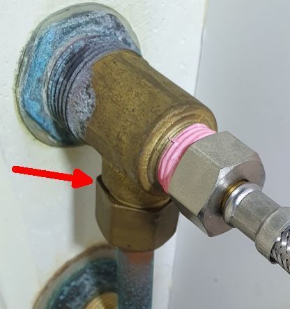

The first thing you need to do is try and tighten the fitting closest to the drip. Since the drip is hanging off the copper section next to the compression fitting, please tighten the compression fitting. It might need just a slight tightening to re-seal the leak.
Please let us know once you've attempted to tighten that fitting, and if it doesn't work, we'll continue troubleshooting further.

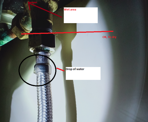

Have tighten the nut where the drip was, however, noted that the drip was at the bottom of the hose as below. Suspect it originates from the wet area at the top :- Could that be washer issue or other?? If to change the hose, is it a big job?
