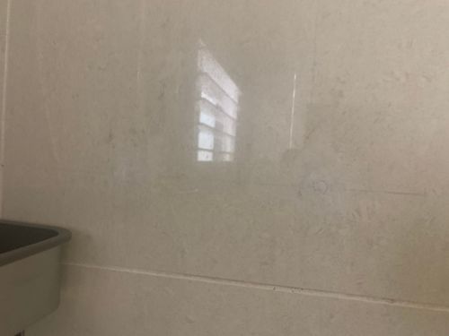

parisMof
Re: How to fix hole in tile?
Hi @EricL
thanks for advice.I’ve done as you have mentioned by pushing the plugs further more
and filled out with Using Selleys 50g Aqua Epoxy Putty Knead It
As you can see the holes not visible anymore which is great.
paris
Hello @parisMof
Thank you so much for posting your repair work. That patch job is fantastic. You would really need to concentrate to see where the holes used to be. But if you were only casually looking you wouldn't even spot them.
