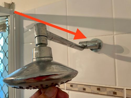

Hi. I have an old adjustable shower arm that suddenly stopped staying in position. It moves at the swivel (arrow in pic). Is there a way to tighten it up again or do I need to replace it?

Typically, shower arms have a tension adjustment for that joint. That doesn't appear to be the case on your unit, as there are no visible nuts or screws. Likely, it had an internal mechanism that held the joint in tension, and that has failed. I'd recommend the best course of action would be to replace the shower head and arm. It's quite literally a 15-minute job, and here's a helpful article to assist with it: How to change a shower head.

Is that a cover seen at far right of @Rdonair 's top photo.
Could it be hiding a locking nut?

Quite possibly, @Noyade. I'm not familiar with a design like that, but I would have thought there was potentially an access point to the innards.

Thanks. I did wonder - but can’t figure out how to open that😁

If you are interested to get the cover off, I propose using a Craftright 11 Piece Precision Screwdriver Set. I suggest using the 1.2mm flat head screwdriver and inserting it in between the tiny gap between the arm and outer cover. This should allow you to lift the side cover that is hiding the fixing nut inside.
However, installing a new shower head such as the Estilo 3 Function Hand Shower WELS 3 Star 9L/min would be more convenient than having to repeatedly tighten the arm every week.

I have a similar set of screwdrivers and I’ve just tried them. Even the smallest won’t fit into the gap on the right hand end where the cover is. Either it’s a very tight fit, or maybe it isn’t a cover? Would something like WD40 help loosen it up? 😁

Using WD40 might work, otherwise the only other choice is to remove it with extreme force. Have you tried both sides of the shower arm? Sometimes the cap is on the right-hand side of the fixing.
If you're still having difficulty, I suggest using a Craftright 250mm Multigrip Pliers in order to affect repairs. Please note that the pliers will probably damage the cover and you might not be able to use it again.

Thank you. I will try both sides of the arm. I also see there’s a small hole on the underside of the arm and inside there’s something like a screw or bolt that seems to take an Allen key. Could that be part of the puzzle? 😁
