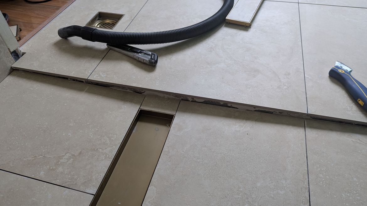

Hi All
Waterproofer did not put a angle at the shower step, and now i am left with quite a large gap to fill, but not sure with what ?
Or should i sikaflex a aluminium angle cut to size, on top of the shower tiles?

I went ahead and very carefully and methodically cut tile to fit in, only to discover its not deep enough for a tile to sit in let alone enough for adhesive, so i grouted it soon after i posted as i had free time. I used a wide joint grout, Dunlop 15kg Mid Grey Wide Joint Grout, thinking it will have better water repelling properties than tile adhesive, and im not too fussed on the look, can barely see this edge. Only thing cant avoid is the grout cracking, in which case it will be easy enough to regrout, which leads me to the next question, should i install the shower screen in a aluminum channel on the "inside" lower area, to minimize the amount of water that can get to this edge but in event of grout cracking cant regrout, or install it on the "outside" and let water run over the grouting? Should i also apply some silicon over the grout ?

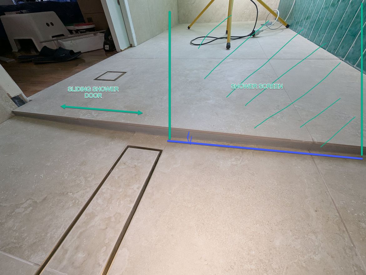

Without doubt the glass has to sit on the top edge. At the least it will be the most aesthetically positioned but most importantly structurally the most sound. Placing the glass on an angled floor will require considerible packing as you won't be able to get the glass cut to match the fall.
If you're installing the glass yourself, then definitely use an aluminium channel along the bottom and wall edge. It will be the most forgiving installation and still be an appealing finish.
For that front edge you have grouted I would ONLY apply a clear waterproofing sealant like this one.

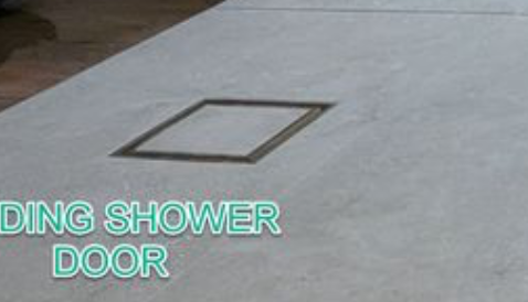

Just a side note @Adriano250RS I just noticed this a floor drain point as it doesn't appear to have any fall in the tiles to direct any overflow water. If this is a requirement in your state and hasn't been installed correctly it will impact any insurance claim.

I'd agree that the screen should go on the top edge and not inside.
You have a waterproofing membrane to catch any water that might get through your newly grouted joint. Applying the Shower Plug @Nailbag has mentioned over the grout in that area is good assurance, too.
