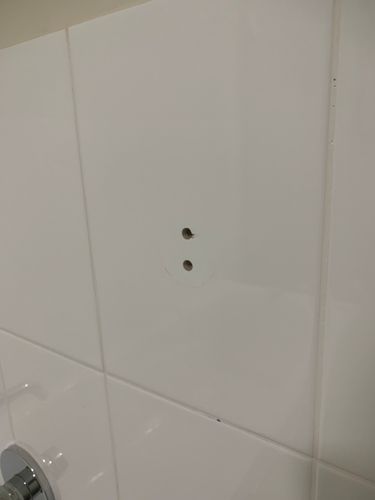

A towel holder fell off in my bathroom, and I decided to fill these holes, how can I fix this? I am very new to DIY projects.
Re: How to fill holes in tiles?
Hi @Yukic,
I'd suggest using Selleys 50g Knead It Aqua Epoxy Putty to fill the holes. Mix the putty thoroughly following the manufacturer's instructions and push it into the holes. Smooth the putty with your finger while still pliable. Once dry, if it needs some smoothing, it can be lightly sanded with 240 Grit Sandpaper to really get it perfect.
