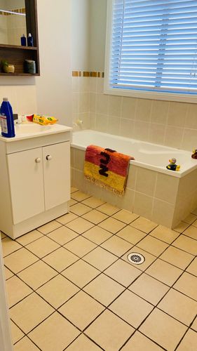

Step 1: First, give some thought to the scope of work! We didn’t, so what was initially going to be a paint job turned into more of a makeover, so we didn’t quite do things in the right order! Having said that….

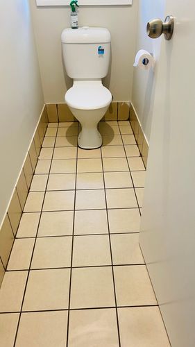

Step 2: Prepare the floor and walls. Initially we wanted to repaint the wall and floor tiles but after prepping the floor and cleaning the walls , decided against the wall tile job in the bathroom because they were an inoffensive colour/design and cleaned up well. The row of tiles in the toilet was painted with the same colour as the floor.
We used mould killer and steel wool to clean both wall and floor tiles and also sugar soaped it. The sugar soap wipes are super handy too. This was a time consuming process but worth it!

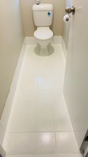

Step 3: Primed the floor tiles ( we did the adjacent toilet as well) using the Dulux product and carefully followed instructions.
Step 4: Leave to dry for at least 24 hours, then did the cutting in/ coating with Dulux tile paint in vivid white. We then Re coated after 24 hours. The result was okay, just…a bit too vivid!!! It looked a bit like an operating theatre! Here’s the toilet as an example of how it looked after…

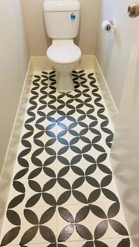

Step 8: Using a tile stencil and brush ( a roller is the best approach, but my stencil was very basic and large, I painted the toilet using the Dulux contrast colour tile paint in tea house. I think it came out really well!! Very hard to get right around the toilet pedestal, and it took a lot of time overall, but it made a very bland space look sensational!

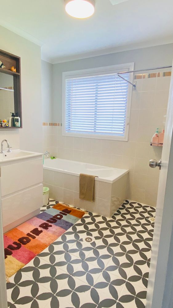

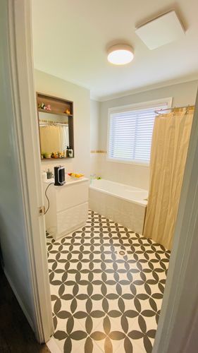

Step 9: Over the new vanity was a very tall wall hung mirror, which we flipped upside down ( it was hung too high to actually look into before). Finally the bathroom floor. I think the paint will be quite durable here but I have done the shower floor and warning you that Dulux DOES NOT recommend this product for showers, it will do though and looks SO much better. So far, so good, it is intact. Eventually we will retile and renovate it his space, but for a bit more than $1200 it has come up a treat. You can see the replacement light and exhaust here, again, a straightforward switch out. The shower curtain is linen and was adjusted to fit as the drop is quite short.
