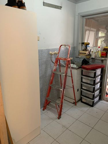

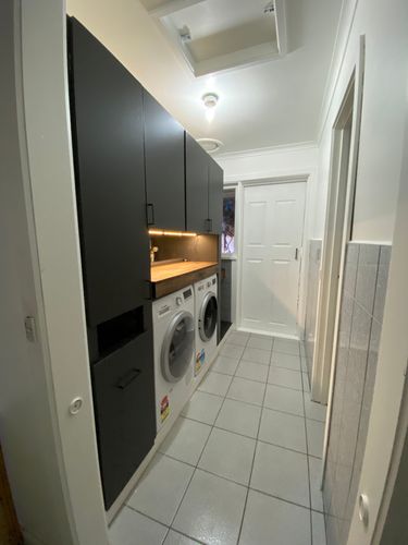

bunnings saved my life. I put up structures in the laundry as I had designed the night before and up it went. Fastened it to the studs and here we have a laundry from 1975 changed to a useable storage laundry.

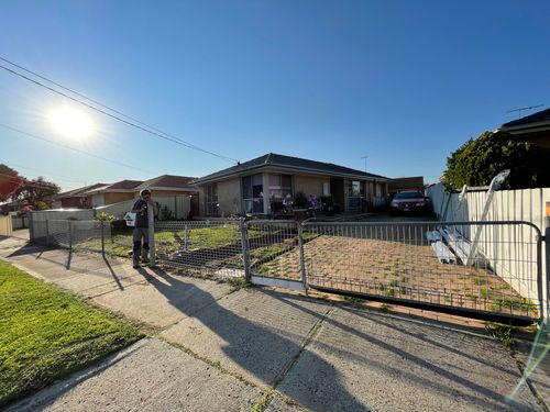

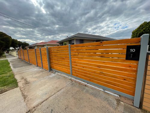

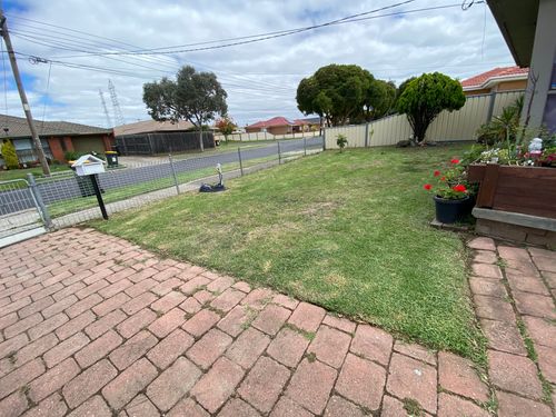

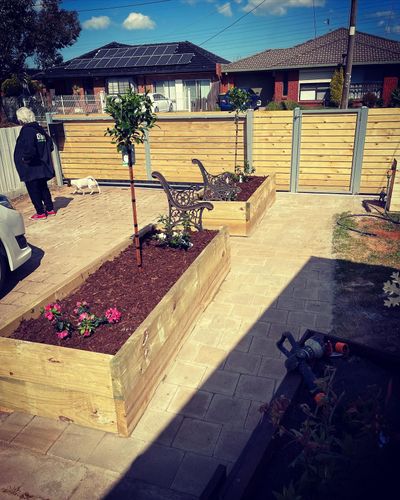

the front yard. Full motorised colorbond fencing and gate. Recycled paved pathway. 2.4x200x50 treated sleepers creating the planter boxes. Filled with premium potting mix.

You've done a tremendous job all by yourself. The front yard make-over is simply lovely, and that laundry reno is sensational. What have you done with the bench there? The thickness is very captivating, and I trust our members will be keen to hear more about it.

the bench top was made with a few different materials. The main material was Specrite 18m pine. I wanted it to be a feature, so I made sure that I waterfalled it by using a butt joint. This was to also to give some protection on the new washer and dryer.  Also did this with another location that you can’t see in the photo, around the sink that’s hiding in the corner.
I added ventilation to the rear of that counter by using recycled pegboard.
