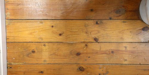

Quick update on fillers - I tried a few options (See image below).
I used Selleys No More Gaps Timber floors. On the left I pressed in raw sawdust on top after applying, the middle is just plain No more gaps and on the right of that I added a little Feast Watson maple stain. The most surprising was the wood glue/sawdust mix. It dried really really dark, which was kind of unexpected. I'm going to leave for 24 hours and see if that changes, but I think the best result appears to be the no more gaps with stain (especially when you're not looking at it from 10cm away with lots of light as in the photo below!)
But wondering if anyone knows what I'm doing wrong with the wood glue/sawdust? It's 1:1 sawdust and Tarzans grip wood glue - maybe I should be using a different wood glue?
Just to see it in context without all the horrific macro detail.
Re: Filling gaps between floorboards in bathroom
@Chris_T,
That No More Gaps with stain is looking fairly close to the coated floor colour. Bear in mind that with the raw sawdust, you are replicating the uncoated, natural timber colour, and it will need to be stained/coated to resemble the coated boards.
I'm really not sure what has gone wrong with your PVA/sawdust mix. It's much darker than what I would expect. You didn't add stain to it at all? Using that method, it should come out almost identical to the raw timber colour. I've got an example drying for you at the moment to illustrate. All PVA glues are white and dry to semi-translucent. I can't imagine where this brown colour came from.
Did another test last night - same issue - maybe the ratios are wrong? I'm doing about 1:1, maybe it should be more 2:1 (more sawdust?)
Hi @Chris_T,
Thanks for the follow-up. Try hitting that dried sample with some sandpaper. I believe you'll find once done, it will be much lighter. My sample has also become much darker overnight, but after sanding, it has revealed a lighter shade. Your sample in the floorboards is a bit too deep to sand, but try it on the sample you've just posted. Use something similar to 120-grit.
Thanks @MitchellMc - sanding does help!
Cheers
Chris
That's great to hear, @Chris_T.
I believe the PVA is creating a coating that needs to be opened up to see the true colour. Keep us update on your progression.
