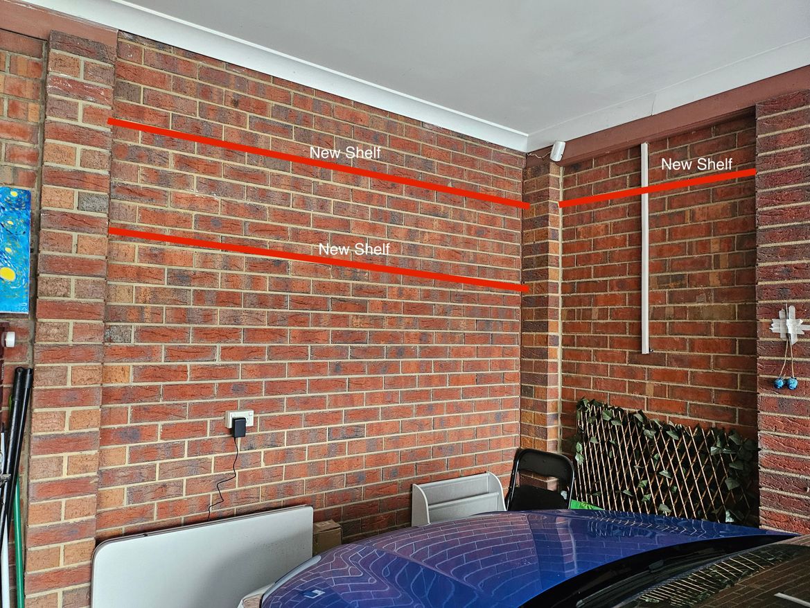

I am looking to install a few overhead storage shelves in my Brick walled garage. I saw this item at bunnings:
https://www.bunnings.com.au/pinnacle-410-x-1140-x-515mm-wall-mount-storage-shelf_p2760334?store=6390...
My question is, could I make my own shelves which would be able to host similar weight (the shelf above states 60kg)
The reason is I have a pretty big wall where I want the shelves, I could purchase 2 of the above shelves but could not fit a 3rd in. If i custom made I can fit the entire wall (and hoping it would be cheaper!)
Also I have a conduit on one of the walls, a custom shelve will allow but to cut 15m hole to fit around the conduit nicely.

note some of these shelves will be above the car bonnet, so i am very keen to have a proper structural shelve!
Thanks

(2) Instead of buying I thought of building then I can customise the shelves' length and fit it around any fixtures in the garage.
I have also attached a picture of my garage for reference
